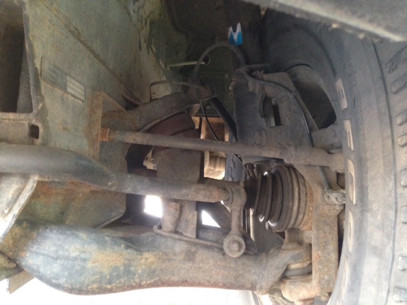

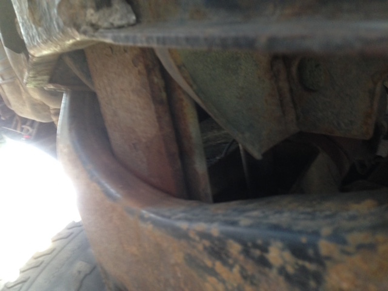

Re: Erweichung der Vorderachse - Iglhaut
hello
yes i agree its not a real offroad but you can drive without broken neck
here is the pictures...i don't think it will be really soft but know it is really annoying ..maybe not the original yellow bumpers will be more softly thank original one..did anyone change it in iglhaut for the Goldsmith?thank you
Ok... If I interpret your 2nd picture correct I would say there is no space on the yellow bumper. I think this isn't correct. There should be at least some millimetres of space to move for the axle. Had you checked your front feather? I know some guy's who broke them and their symptoms are nearby your...
Maybe you can send the picture to 'Opa_R' here in the forum. I think he has great experience with T1 Sprinters.
If the language becomes a problem please contact me, I try to translate.
Hello
sory for late answer..I think in iglhaut version it is normal that there is no space between the axel and a yellow bumper..But i am really not sure..front feathers are i think without problem ...Ok i will try to send him the picture ...thank you for your help...
