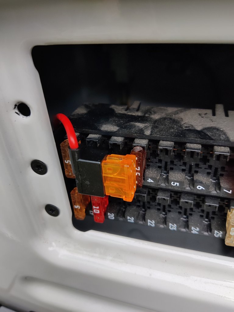

I myself solved it by using this external fuse holder that allows you to run the original wire (if any is connected. Was not in my case) plus a new one which will act as your D+
I attached that fuse holder to a free place which has a wire attached for the back windows wipers or something.
At least my van doesn't have back windows and there is no cable leaving the free fuse holder, it runs Kl15, perfect for me.
I added a switch to decide myself weither the B2B charger runs or not

This seems like something I could actually do without messing up everything! Thanks for adding the picture too. How did you attach the fuse holder to the free place? Is it a special holder or do I need to do something with the cable?
I checked the fuse and relay overview and back window wipers are fuse holder no.2, which it looks like in your picture. That would work for me too, since I don't have any rear windows.
I will go out and check on my van. Otherwise, how do I know which fuse holder runs Kl15? Is Kl15 same thing as ignition signal?
I also just want to check, you write "a free place which has a wire attached" and "no cable leaving the free fuse holder", should I check whether there are cables leaving or will all the fuse holders be connected to some sort of signal?
Edit: I think I found the fuse holder you used. I can't post links since I am new on this forum, but I searched for "piggyback fuse adapter" on Amazon and it looks like it.

No, its a simple fuse holder, which fits in the fuse holder in that board.
You just have to buy the correct size.
The fuses and Relais overview tells you, if it's Kl15.
But at least you can just measure it.
No key or key not turned: 0V
Key turned in first or 2nd position: 12V
This seems not be ideal, but it's easy to achieve
You may even find a holder that runs 12V only in 2nd key position (engine runs)
Folgende Benutzer bedankten sich beim Autor wlfnkls für den Beitrag:
freestyleframework (08 Jan 2023 15:57)

wlfnkls hat geschrieben: 08 Jan 2023 15:55 No, its a simple fuse holder, which fits in the fuse holder in that board.

There a different size for that kind of fuses.
Since I'm not sure which size you need (and I'm currently hiking in Italy ;) ) you should measure the fuse that sits in the board of your van.
Good luck!
Ah...
If you want to use Kl15: keep in mind that if you want to run the radio without engine running, your B2B charger will run, too. This is another reason why I placed a switch
Niklas

freestyleframework hat geschrieben: 08 Jan 2023 15:51 I also just want to check, you write "a free place which has a wire attached" and "no cable leaving the free fuse holder", should I check whether there are cables leaving or will all the fuse holders be connected to some sort of signal?
My bad, sorry.
In my case, there is only 1 wire attached to the fuse holder.
Since it runs 12V, but has no second wire connected, it means that there is a signal, but no electrical part uses it.
You will find holders with more than one cable connected or even with no cable connected.
In my case, I felt safe enough knowing that there is no other part consuming from this signal.
Hope this is clear now :)
